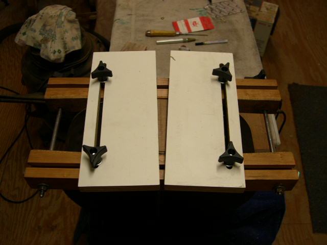

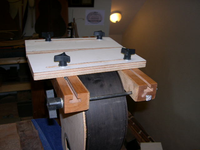

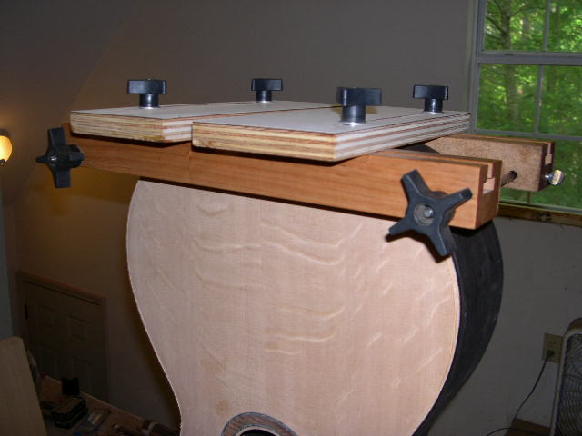

...I solved one of my dilemmas. That of routing the tail wedge. I can't remember who first posted a pic of that jig , but I certainly thank you. Here is my rendition of the tail wedge routing gizmo:
The rails are cherry, and the adjustable table is formica-covered sink cutouts (don't throw those scraps away). I didn't have any slotted track on hand, but I did have that T-slot router bit. Works fine. The bottom rail is cut on a 15' radius, and the top to a 25' radius (to match the back and top curvature). The guide rails are threaded on both ends, which allows the thing to be self-clamping.
This isn't yet the last word, but I'm happy with the unit.
And again, many thanks for the inspiration!

Gorgeous looking guitar top there too!!

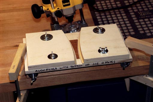

Below is a jig from Tue North Guitars. It looks like there's a lower lip on the bottom of the jig. I like the fair curve/bugle design.
Is this a setup that can both rout the inlay as well as the cavity? Anyone explain, post their own pics?

Hi Terry, that's something I might have to try in the future. The thing that recommended itself to me about the jig I "copied" (stole), is that it accomodates itself to any inlay you've got. Well, any straight sided inlay that is. You lay the inlay in place, bring the adjustable table up to it, remove the inlay, and go to it with your pattern cutting bit. Only I use a dado cleanout bit.
Thanks for the kind words guys, and yes, I think that bearclaw S***a top will look nice under finish.

Steve, that's a nice solution, thanks. But--the thumb screw...what's the thumb screw for? AAAAAARRGG!
Oh, wait...does it pin the rod?

Carlton--yes, the thumb screw does pin the rod. The cherry is tapped to accept the 1/4 20 thumb screw.

I use a very similar jig to Steve's, but mine is permanently set to a given taper, with teh guides being 3/8 plexi. It is on rails which self clamp as well. I use a 1/4 inch downcut spiral, and can vary the wedge size by using different sized guide collars.
One could use a jig like the true north one to make the cavity and inlay piece by using one of those inlay router bit sets - it has an 1/8 inch bit (I think) and a guide collar, plus a bearing sleeve that fits over the collar to change the size to make in the inlay (check a lee valley catalog) - the idea bulb just went off !!!!

Michael, the same thought occured to me, and I will be trying the collar guide at some point. The smallest top bearing bit (by the way, Greg, there's your answer) that I have is 1/2", and I had to finish the last little bit of the rout by hand on one guitar. Now, Stew-Mac does sell a 3/8" diameter top bearing router bit....
